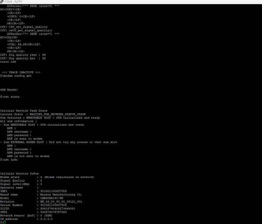

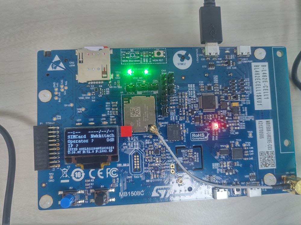

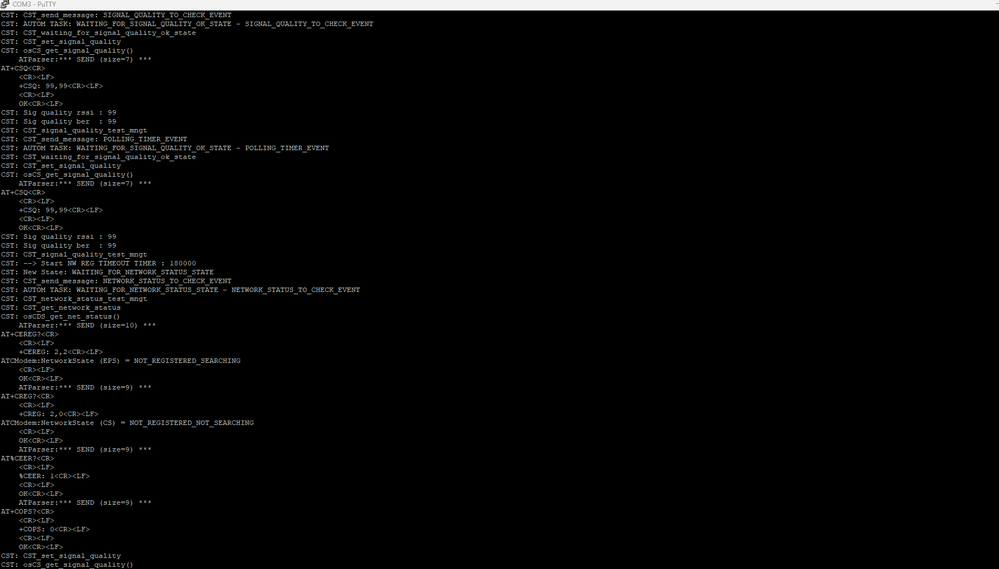

I am unable to connect to the network, it shows the network attach on the oled display but the network strength is zero. Tried different sim cards, but still not working. Also unable to configure modem using AT COMMANDS shows " at command fail". I am attaching some screenshots of the serial monitor and board for reference. 0693W00000bhZGwQAM.png0693W00000bhZGrQAM.png0693W00000bhZGhQAM.jpg

Can you provide a complete log file ?
In which country you run the test ?

here I am attaching log file. I'm running the test in INDIA. I'm using regular 4G Simcard of JIO carrier(not m2m simcard). I tried but there is no network using the original preprogrammed code that came with discovery kit.

By default modem FW is LTE CatM, TP eSIM is for LTE CatM so it matchs.
In case you must use a plastic SIM card there are 2 possibilities.
Either it is a SIM card for a LTE CatM network in this case it should work without modification.
Either it is a NBIoT cellular network in this case an AT command must be used to switch modem fw from LTE CatM to BNIoT.
Note to reuse the device on LTE CatM a similar AT command must be used.

I tried this command (at at%setacfg=radiom.config.preferred_rat_list,"CATM" for Cellular LTE CatM) on teraterm terminal, but nothing happened or no acknowledgement or no response i'm getting from the controller. How do i know that command has been set or sent to controller. I am attaching the log file, please take a look.

Do not "trace off"
And:
at at%getacfg=radiom.config.preferred_rat_list
Your trace indicates : at at%setacfg=radiom.config.preferred_rat_list,CAT"CATM"
which is noit the command I provide you.
