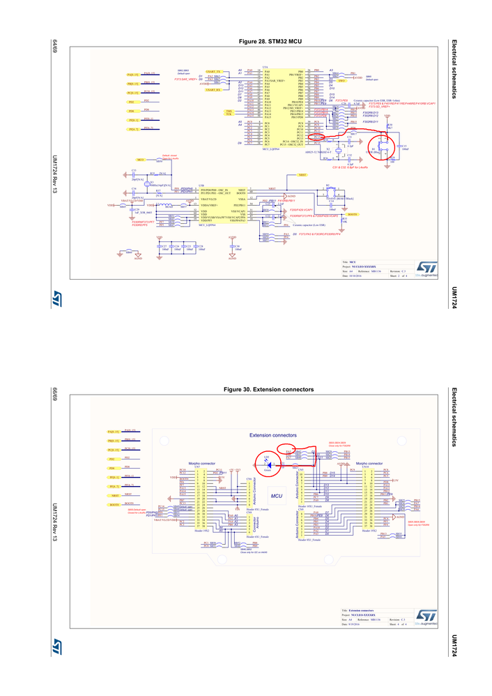

I have a STM32L476RG board and I try to execute the following program, obtained from this web http://www.microdigitaled.com/ARM/STM_ARM/Code/Ver1/Chapter02/Program2-1.txt which is for a different Nucleo 64 board (STM32F446RE)

I can compile and load the file to the board but it does not turn on green led, and it doesn't matter if I press the switch,
I guess that the problem is that both boards have different memory sizes and adddresses for registers (lines 10-12) or maybe led and switch is connected to different port and pin in my board, but: I do not know where to find the addresses and pins where onboard led and switch are connected
Where can I find this info?
thanks in advance
Marcos
waclawek.jan
> which pin and port are connected the user led and switch?
Yes the Nucleo UM is not the example of well-executed document,. but generally the schematics for the STM32 devboards are quite well usable. (Maybe that's why ST does put them into the new devboards' UMs...)
14 REPLIES 14

Anyway, I still need to know the port and pin where onboard switch and led are connected. The sheet included in the package is not very informative, and the info in STM, again, is not easy-to-find.
The reference manual and the datasheet cover the microcontroller only. You can find the register addresses, pinouts, but whatever the board makes has put on the board is outside the scope of these documents.
Boards made by ST have a product page on the website, where you can access the board user manual under resources / technical documentation, and there should be a board schematics either included in the user manual, or provided as separate document on the same page.
Boards made by third parties might or might not come with schematics, contact the distributor or the manufacturer if you can't find it.

waclawek.jan

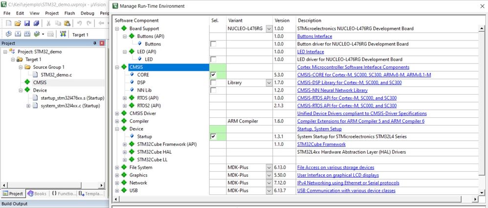

finally I succeed thanks to this nice page with addresses for different microcontrollers http://libopencm3.org/docs/latest/stm32l4/html/modules.html
The difference of my board (STM32L476RG)  with the other board (STM32F446RE) is that clock activation is with RCC_AHB2ENR and not with RCC_AHB1ENR
this is my code with direct register definition (more definitions than required for future extensions)

Using CMSIS definitions from the MCU header, it would have been immediately apparent at compile time that RCC_AHB1ENR_GPIOAEN is not defined, but RCC_AHB2ENR_GPIOAEN is.
I have an empty CMSIS section. Which option do you suggest?
