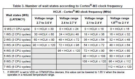

I'm using STM32F217IGT.
I want to know changing VDD anytime.
I think.
1. change firmware correction VDD(3.3V firmware or 1.8V firmware)
2. change system clock configuration void SystemClock_Config(void) in main.c
 --> 7WS

If you set the system clock/waitstates for 1.8V, you can use any VDD value.

If i set 7WS, i can use any VDD value?
I added capture Table3. Number of wait sate...
It's difference Voltage range...
Thank you!
waclawek.jan
Yes.
