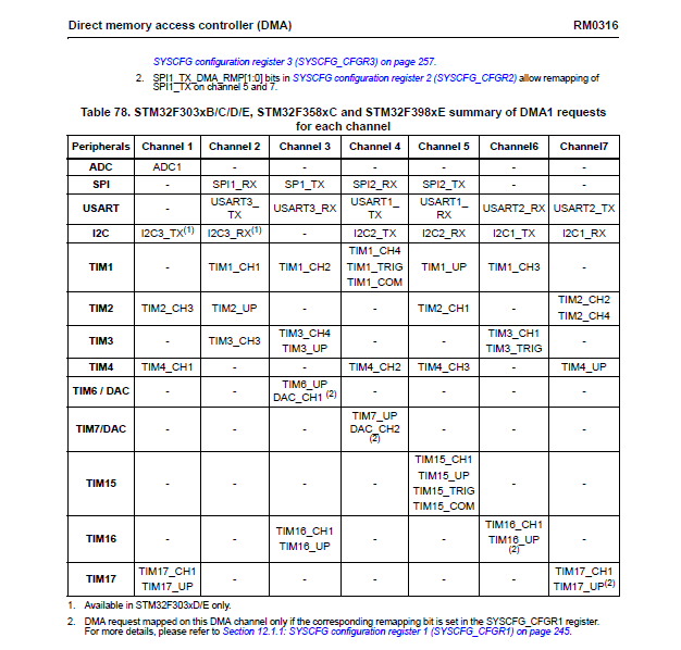

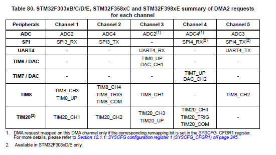

I appear to have solved the issue. Looking further in the datasheet I realized that ADC2 was not connected to DMA1 channel 1
The correct DMA connection to ADC2 is DMA2 Channel 1:
