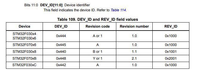

What is the unique device ID for STM32F030C8T6?

Thanks for your fast reply, And the unique device ID address is the same as stm32f105(0x0x1FFFF7AC)? Because there is no mention in RM0091 reference manual.
‎2019-03-07 12:03 AM
The reference manual related to the STM32F030C8 device is RM0360.
You can find the devide ID in this RM in section "26.4.1 MCU device ID code".

will you share RM0091 becuse I can't get this file name I have already check reference and programming manual of stm32f030C8T6.
‎2019-03-07 12:16 AM
Hi @LACTIC​ ,
Here is the link of RM0091 Reference manual which is relevant to the STM32F0x1/STM32F0x2/STM32F0x8 MCUs and not STM32F030.

But if "dev id " is device id so what is how it is different from UID.

After check, there's no unique ID for the STM32F030.
