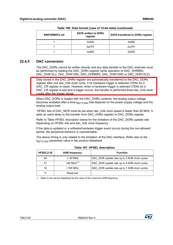

What is the relationship between the DAC_DOR register value and the DAC_DHR register value? I use STM32G431C8T6.

In STM32H7 DOR is the read-only actual output register, which is fed by one of the several alignment-dependent "input" registers to the peripheral.
