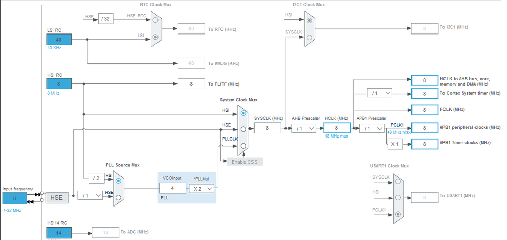

i'm trying to create a delay function for microsecond delays. But it doesn't work. I couldn't understand where the problem is. Could you please let me know?
(i'm using stmf030f4)
edit: To understand where the problem is i'm trying to create a milisecond delay function. And i set delay to 1000 miliseconds. But i see 8 seconds as a result. (and if set delay to 500 i see 4 seconds delay )

Note that systick is 24-bit. And with 8 MHz systick clock, 8000 = 1 ms. One second (0x7A1200) _should_ fit, though.

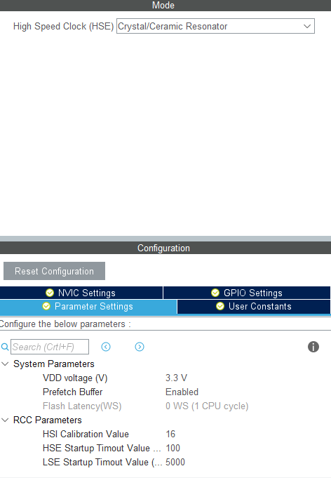

turboscrew
Senior III
Maybe you should check from the generated code, that the clocks ate, indeed, set up the way the picture shows. Especially check the systick clock divisor selection bit.
I recall that bit defines whether the systick runs in the bus clock speed or if the clock is divided by 8. At least Atollic debugger shows the HW registers.
thank you now it works fine. i added these.
SysTick->CTRL &= ~SYSTICK_CLKSOURCE_HCLK_DIV8;
SysTick->CTRL |= SYSTICK_CLKSOURCE_HCLK;
