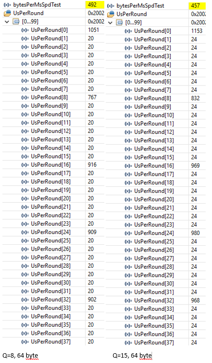

I am trying to get a hight speed write to SD via SDIO as well. I use a project generated with Cube MX, 4bit SDIO and DMA. But I only get a write speed of about 300 kBytes/s. I write 1000 times a 100 byte block, because I need a write about every 100 us. With a 100 byte block I have a write time of about 25 us, but every fifth time over 1 ms. Weird...The time span to the 1 ms write decreases the less bytes I write.
When I look at the trace of TrueStudio, I see that more than 60% of the time is spend in the function SDMMC_GetCmdResp1, compared to only 0.05% in BSP_SD_WriteBlocks_DMA... (Screenshot attached)

Then, when I understand it right, the full speed is only available when writing large blocks and not with small blocks e.g. less than 100 bytes via SDIO and the ST FatFs?
What do you think are the transfer peeks shown in the screenshot attached?0690X0000060824QAA.png
I might have to speed up SDIO and FatFs by going an own way with less calls to card status and handling the Fat accesses by myself?
