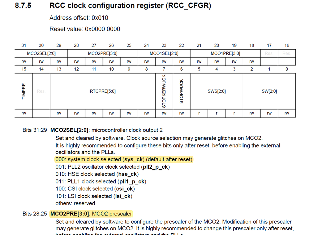

I want to verify the system clock running frequency of STM32H7B3 MCU (It support up to 280MHz).
For example, If we configured SYSCLK is 256MHz in STM32CubeMx Software. How we can ensure the MCU is running at 256MHz clock speed.
uint32_t HAL_RCC_GetSysClockFreq(), by using this function call we can get SYSCLK frequency using register calculation. But, we can't to check the visual results like oscilloscope output.
I tried to measure the system clock by generating MCU clock signal from MCO1 GPIO pin. Normally, GPIO have some speed limitation. What is the maximum speed we can measure using this MCO1 pin?

You can use MCO2 to output an image of the system clock:
Select a prescaler value in a such way to not exceed 100MHz.

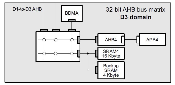

Bit banging the GPIO on the H7 is a lot slower than other STM32, parked off of AHB4/APB4.
Ditto driving with DMA and Pattern Buffers.
