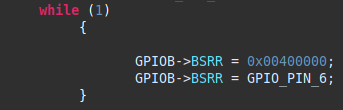

i made test with F303 , at 72MHz; for building a "mini-DSO" ...
HAL uses some clocks , about 260ns for 1x lo-hi-pulse,
but when writing direct to port , with optimizer -Ofast (speed) :
0693W00000UoV1PQAV.pngmeas. about 15ns (ideal 13,9ns = 1 tick 72MHz); so really 1 clock tick.
