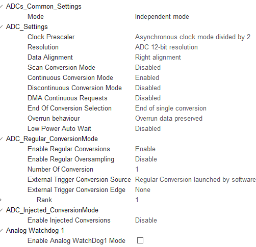

What is the channel for ADC2_IN7 on pin AC2 in the STM32L4RG

Hard to say. AC2 isn't a pin and STM32L4RG isn't a chip or a board. Sure you typed those right?

My bad. Chip is STM32L476RG. Pin used is PA2. Code generated by the CubeMX is
 hadc2.Instance = ADC2;
 hadc2.Init.ClockPrescaler = ADC_CLOCK_ASYNC_DIV2;
 hadc2.Init.Resolution = ADC_RESOLUTION_12B;
 hadc2.Init.DataAlign = ADC_DATAALIGN_RIGHT;
 hadc2.Init.ScanConvMode = ADC_SCAN_DISABLE;
 hadc2.Init.EOCSelection = ADC_EOC_SINGLE_CONV;
 hadc2.Init.LowPowerAutoWait = DISABLE;
 hadc2.Init.ContinuousConvMode = ENABLE;
 hadc2.Init.NbrOfConversion = 1;
 hadc2.Init.DiscontinuousConvMode = DISABLE;
 hadc2.Init.ExternalTrigConv = ADC_SOFTWARE_START;
 hadc2.Init.ExternalTrigConvEdge = ADC_EXTERNALTRIGCONVEDGE_NONE;
 hadc2.Init.DMAContinuousRequests = DISABLE;
 hadc2.Init.Overrun = ADC_OVR_DATA_PRESERVED;
 hadc2.Init.OversamplingMode = DISABLE;
 if (HAL_ADC_Init(&hadc2) != HAL_OK)
  Error_Handler();
 /** Configure Regular Channel
 sConfig.Channel = ADC_CHANNEL_7;
 sConfig.Rank = ADC_REGULAR_RANK_1;
 sConfig.SamplingTime = ADC_SAMPLETIME_12CYCLES_5;
 sConfig.SingleDiff = ADC_SINGLE_ENDED;
 sConfig.OffsetNumber = ADC_OFFSET_NONE;
 sConfig.Offset = 0;
 if (HAL_ADC_ConfigChannel(&hadc2, &sConfig) != HAL_OK)
  Error_Handler();
Using CubeMX settings:
