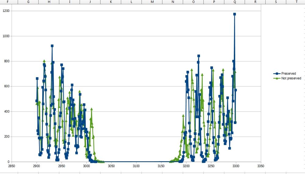

I have successfully configured the adc watchdog. But i am a bit dissapointed of the accuracy. I set the bounds to 1000 and 3000, but when i read the values of the adc from the watchdog interrupt, i get also values from within the window (up to 1025/2975).
The signal is 10Hz Triangular. I already measured the time from beeing outside of the window until the interrupt is executed (4us). So there is no timing issue.

I made a diagram, to visualize it and added a cap to smooth out the signal:
_legacyfs_online_stmicro_images_0693W00000bijYFQAY.png x-axis shows the value from the ADC, and the y-axis is the number of measures values. The window has been changed to 3000/3200.

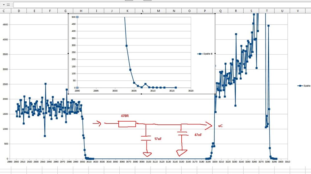

I think i found the problem (probably, as there is a lot of code just for the ADC) in my case: The EOC interrupt cleared the EOC flag, which itself reset the preservation of the ADC dataregister. And i thought this would only happen when i would read the dataregister.
I found this int the datasheet, which is not clearly stating this:
"EOC flag is cleared by the software either by writing 1 to it or by reading ADCx_DR."
At the relevant point in the datasheet there is no information about this:
It is possible to configure if data is preserved or overwritten when an overrun event occurs
by programming the control bit OVRMOD:
• OVRMOD=0: The overrun event preserves the data register from being overrun: the
old data is maintained and the new conversion is discarded and lost. If OVR remains at
1, any further conversions will occur but the result data will be also discarded.

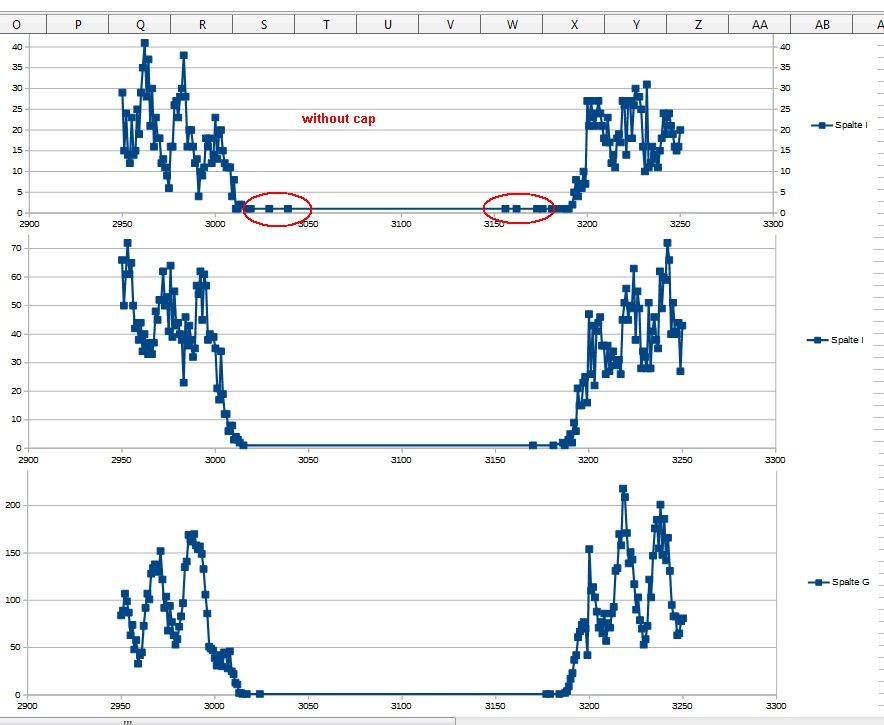

I could now improve my measurements a tiny bit. As i did forget about my signal i used, there were some artifacts (valleys and mountains in the signal). Those came from the DAC that was generating the signal.
But still the values when the watchdog fires are not precise. My test setup is on a breadboard. The increasing numbers to the right are, because the signal curve flattens at higher level, and produces more measured values. The signal is a 2Hz triangular (somewhat) waveform.

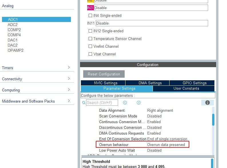

No, i have set the option to preserve the data in the register. I thought "well thats it" but i was quite dissapointed as it didnt change much. Or maybe there is more to it?

I have now checked on the preserve option in particular. It works as expected. But the watchdog is still not working as it should. I have read in the manual:
The watchdog comparison is performed on the raw converted data before any alignment calculation and before applying any offsets (the data which is compared is not signed).
When it says "Data", there should be no watchdog interrupt that has a value of between 3000 and 3200.
