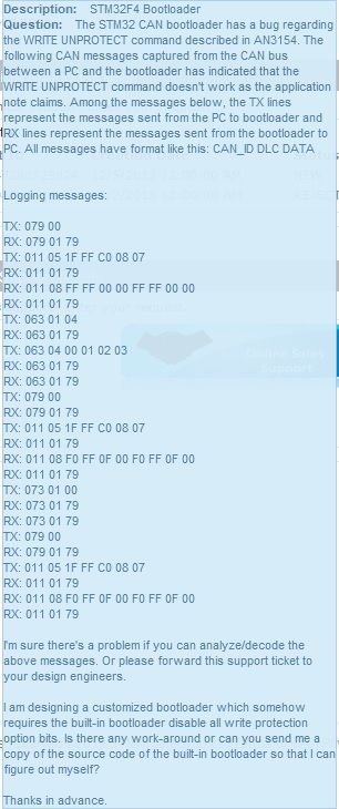

First of all, if my post offended anybody, I apologize. I am just a little bit of pissed off by the issue causing the delay on my schedule.
I realized probably I didn't give enough info so my first ticket got rejected. Therefore I initiated another ticket with much more information, hope they can take serious this time. It seems not easy to retrieve the ticket content in text format, so I captured the screen shot and posted below. If anybody read this post and has the hardware and software to repeat my exercise described below, please report your results. Your effort will be highly appreciated.

Posted on December 05, 2013 at 17:43
I'm not offended, I'm just trying to be pragmatic and provide perspective.
I don't work for ST, but I've done my share of product and chip validation. The quickest route to resolution is to confine the problem, and demonstrate it in a complete and undeniable fashion. Having others confirm your observations is not nearly as useful as being able to provide multiple sources of evidence yourself.
The options viewed via the ST-LINK, and serial connected system loader, would provide additional confirmation. As would data output from your code running on the device.
