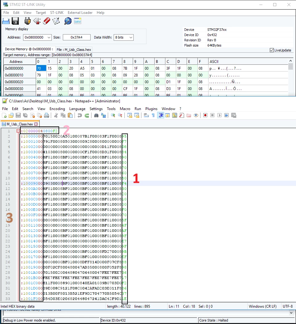

Posted on August 11, 2017 at 14:20
When I looked up the stlink utility , I couldnt see 1,2 and 3 shown in the figure?What are these can sb tell me about it?

    Posted on August 11, 2017 at 14:52
    The .HEX file is in an Intel format that defines record structure.
    1) Checksum field for the record
    2) is a segment address, other records use 16-bit address, so only describe 64KB regions.
    3) Is the record size, address, and type
    https://en.wikipedia.org/wiki/Intel_HEX

    Posted on August 11, 2017 at 14:57
    I also found this line at the first line => :020000040800F2
    and this two at the last line =>             :040000050800018965
                                                                :00000001FF
    I didnt found these in intel hex

    Posted on August 11, 2017 at 17:54
    Did you read the Wiki? The .HEX is an ASCII encapsulation format, not all the record content gets into the memory of the device.
    Record Type 04 at the front is describing what memory window the following record fall into, ie 0x08000000 being the base of FLASH memory
    Record Type 01 at the end is a terminal record
    Record Type 05 is the execution/entry address, nominal points at Reset_Handler
