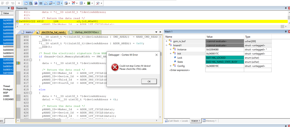

Hi
My code stops after i use the HAL_NAND_Read_ID function, Also the debugger stops working and i can see no errors to solve.
Thanks for helping me.

I use cubemx v6.3.0 as code generator and stm32h7 v1.8.0 softwarepacket.
I just config the nand timing and generated the code.
Here is the main code:

	HAL_UART_Receive_DMA(&huart1,gsm_rx_buf,sizeof(gsm_rx_buf));
	if(HAL_NAND_Read_ID(&hnand1, &my_nand_flash) != HAL_OK)
		Error_Handler();

Hi again Imen
I tried everything about this nand flash thing but still the problem is not solved.
Im just using fmc without any other dma or nothing else but with keil mdk arm the debugger stops after i launch the read id line. Just the erase page works. even when i try write page the debugger stops working.
I tried the same code with cube ide. The debugger does not stop but the hole code not excecuting corectly when i use read id function.
