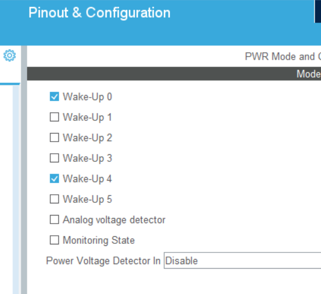

I have a custom board with an led on PD7 and Normally High push button on PI11. There is also a pushbutton set up on NRST. Device is a  STM32H743IIT6
I can get the processor to go into standby okay. This is confirmed by the __HAL_PWR_GET_FLAG(PWR_FLAG_SB) == SET being false if I repower the circuit but true if I push the NRST button. So far so good.
I can not get the processor to wake on the PI11 PWR_WAKEUP_PIN4.

OMG! I found it. ST HAL Library engineers please take note. This is horrible. The wakeup pins in the datasheet and in the CubeMX configuration are 0 to 5.
0693W00000GYVIDQA5.pngHowever in the HAL PWR library.... surprise! they are 1 to 6.

There is a mapping wakeup 0 is HAL wakeup 1 etc. Where is this mapping documented? Why even do this mapping? Who comes up with this stuff???? Thanks, You just cost me 1.5 days of wasted effort.
