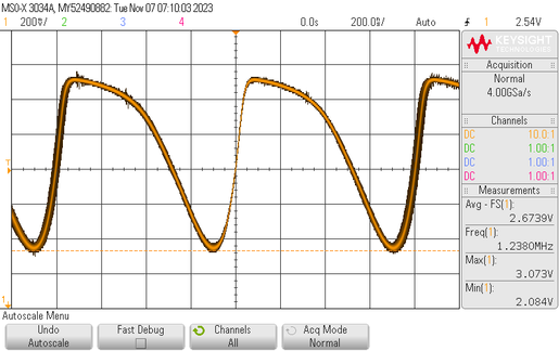

I have VREFBUF configured for output to comparator on my board. I see this on MCU Vref+ pin...
  1. Is 1.2MHz waveform typical? Are capacitors on Vref+ expected to smooth?
  2.  I looked for avg closer to 2.5v (VREFBUF_VOLTAGE_SCALE0). How close to 2.5v should this be?
VREFBUF_CSR = 0x09.

mccabehm
Senior
The waveform above does not appear until I set ENVR in VREFBUF_CCR. No GPIOs active.
There is no 1.2MHz coming from the board.
Does this waveform mean that Vrefint is not steady? If yes, this would seem bad news for ADC accuracy.
Bob S
I don't know specifically about the H5 series chips, but generally, yes, you need external caps on the VREF+ pin for stability.  For the F4xx ST recommends 1uF and 100nF in parallel.

Moving caps as close as possible to MCU (mentioned in DS14258 under General PCB design guidelines) fixed this for me.
