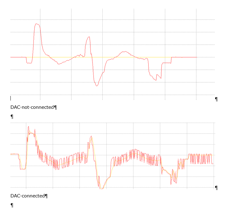

0693W00000Dnj6TQAR.pngI insert an external opamp with a low filter and follower opamp Rail to Rail.
In the file attached, you can see 2 curves: yellow is what the motor driver measure. So is the ideal set point of the motor. So is simply the voltage of the DAC; the red is the feedback of the motor driver so it is its real behaviour. In the first curve, when the DAC is open and not connected to anything the red curve is "clean" and the yellow is flat because there is nothing connected.
in the second curve, when I connect the DAC to the ADC of the motor driver, the red curve is not clean anymore.
the analogue input of the motor driver is 50k.
waclawek.jan
How did you measure those waveforms? How exactly do you connect DAC to ADC?
The ADC is a significant pulsed load, at every sampling moment the sampling capacitor is connected, so it has to be driven from a high-impedance source.

I have found out why there was this strange waveform.
But I did not resolve my last issue: without an external reference of 3V, the DAC1 at 4095 provides 3.3V and the DAC2 3V. With the external reference and removig the bridge SB10 on my Nucleo I have the same behaviour. Should I modify something else in the Software or Hardware?
FTrom
I have found the cos and so also the solution of my issue. The Nucleo received signals for the 3.3V from the encoders. Apparently, somehow those created some instability in only my DAC not buffered. An issue that did not appear with the STM32F303RE.
