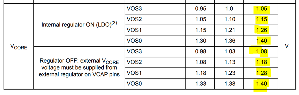

I designed a custom board with an STM32H723ZGT6.
It worked fine, then, long story short, this happened:
I accidentally connected the VCAP pins (Vcore voltage) to 3.3V, then switched the board on. After about 2...3 seconds I realised something is wrong, because the LED I expected to blink, remained off, so I switched the board off immediately. Then I disconnected VCAP from 3.3V, and switched the board back on.
Now it seems to work properly, the LEDs are blinking and the ethernet also works. On VCAP I measure 1.38V, which is normal.
Is it possible that the MCU survived entirely the 3.3V Vcore voltage for a couple of seconds?
Or can there be some partial damage that cannot be seen now?
I haven't found any maximum for VCAP in the datasheet.
Both are possible, the former is more likely if the chip is working properly now.
They're in there, in 6.3.1 General operating conditions.
vjaz
Thanks for your reply! I hope, you're right.
(Sorry, it was not clear, I meant that there is no entry for Vcap/Vcore in the "Absolute maximum ratings" part.)
