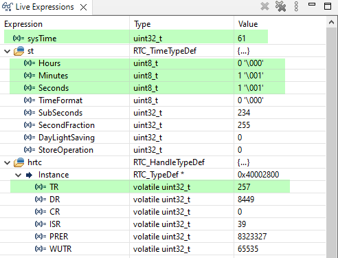

I have a very strange issue with an STM32F405RG/407VG regarding the RTC: it only works, when I am in debugging mode and add the “hrtc�? struct into live expression and the instance handle is open!
My code is pretty simple:

The intended behaviour is:
a)   Toggle the LED1 to indicate the program is running
b)   Toggle the LED2 when the “sysTime�? variable has changed.

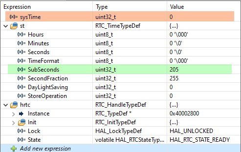

But what happens instead is:
When I am in debugging mode, and have hrtc->Instance open in the “Live Expressions Window�? LED1 and LED2 toggle as intended.
hrtc->Instance closed => "sysTime" is not updated
hrtc->Instance open in Live Expressions => "sysTime" is updated
0693W00000KcPWNQA3.pngWhen I close the debugging mode LED1 keeps toggling, but LED2 stops toggling, which means that “sysTime�? is no longer updated.
Has anyone an idea, what’s going on here?
I am using CubeID 1.9 with F4 Drivers “STM32Cube_FW_F4_V1.27.0�?
Some Additional Info:
This issue popped up in a bigger project with an STM32F407VE. For debugging purposed I build this simple programm on an F405RE, where i could reproduce the behavior.
When I close CubeIDE, remove the power from my test board, and power it up again after a few seconds, the LED2 does not toggle. This means the RTC is dead, except I am in Debuggin mode and having a probe set on hrtc->Instance
The same Code is working well on a Bluepill (F103C8).

After reading time, you have to read date too.

@JW thank you very much! This did the trick!
My GetTime() function now looks like this:
void GetTime(void) {
	RTC_TimeTypeDef st;
	HAL_RTC_GetTime(&hrtc, &st, RTC_FORMAT_BIN);
        #ifdef __STM32F4xx_HAL_H
	RTC_DateTypeDef sd;
	HAL_RTC_GetDate(&hrtc, &sd, RTC_FORMAT_BIN);
	UNUSED(sd);
        #endif
	sysTime = (((((uint32_t)st.Hours) * 60) + ((uint32_t)st.Minutes)) * 60) + (uint32_t)st.Seconds;
@PHolt: luckily i don't need fractional seconds ATM, my "complication bucket" is full for today ;) - but thanks for the warning!
