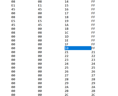

Hello Community,
Using the USART commands in boot mode on a STM32H723 CPU, I faced following issues:
Extended erase (0x44) and writing memory(0x31) to the flash works fine, if I write ALL bytes in blocks of 256 bytes.
But if I do a read memory(0x11) after writing one block for verify purposes, I get FFs on the first bytes instead the correctly written data. This happens exactly after the second read block always, even if I write 4 blocks and do the readback then.
The STM32 CubeProgrammer also only supports verification AFTER writing all data to the flash, not block by block.
Is this a generic limitation in the boot loader ?

Could you check the start address to read the memory. It's possible that you are reading from the wrong address, which is why you are getting FFs instead of the correct data.
‎2023-11-29 2:56 AM
Hello F.Belaid,
the verify start address is correct. The problem arises exactly in the first 32 bytes of the second block. See the attached text file which shows the communication.

‎2023-12-13 11:34 PM
Hello F.Belaid,
Thank you for your support. The Chip is a STM32H723 VGH6. For the boot protocol infos see following infos from the cube programmer:

‎2023-12-14 5:48 AM
Hello again @TomKing
Waiting for a response from the team Internal ticket number: 168821 (This is an internal tracking number and is not accessible or usable by customers)",
However, I noted here while writing instead of 10 this should be 20. I guess this should not affect the overall behavior.
‎2023-12-14 5:55 AM
No, the data is not important, just to find the point when no 'FF' is read out. Value 20 comes later (after 2F).
‎2023-12-22 3:03 AM
Hello @TomKing
We can confirm we have reproduced the issue. We have two workarounds available for the moment:
- Write all the needed data at once (no read every 256 bytes) then check all the data.
But before sending any new write command after the read command used to check the data, we must write dummy 32 bytes in FLASH before writing the needed data. - Or add an extra dummy write of 32 bytes after each read operation:
Write 256 bytes @ 0x08000000
Read 256 bytes @ 0x08000000
Write dummy 32 bytes @ 0x08000100
Write 256 bytes @ 0x08000100
Read 256 bytes @ 0x08000100
Write dummy 32 bytes @ 0x08000200
Write 256 bytes @ 0x08000200
Read 256 bytes @ 0x08000200
till the end of data.
