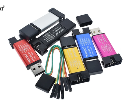

Are you using a genuine ST-Link?
ie, not something like this:

Yes:) and also have
https://www.st.com/en/development-tools/st-link-v2.html
I was able to solve my problem: View-> Periodic Window Update is enabled
