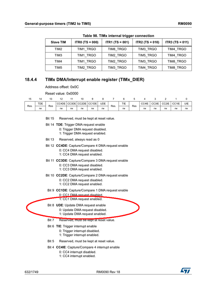

waclawek.jan
> TIM4 -> DIER |= (1UL <<(14U)); // UPDATE DMA REQUEST ENABLE
Are you sure? I don't have RM at hand but this doesn't sound right to me.
Why don't you use the symbols from the CMSIS-mandated device header?

I'm sorry, I had this register set as:
TIM4 -> DIER |= TIM_DIER_UDE
and it didn't work for me so I started to mess around and forgot to put it back to what it was originally.
It is back to TIM4 -> DIER |= TIM_DIER_UDE .

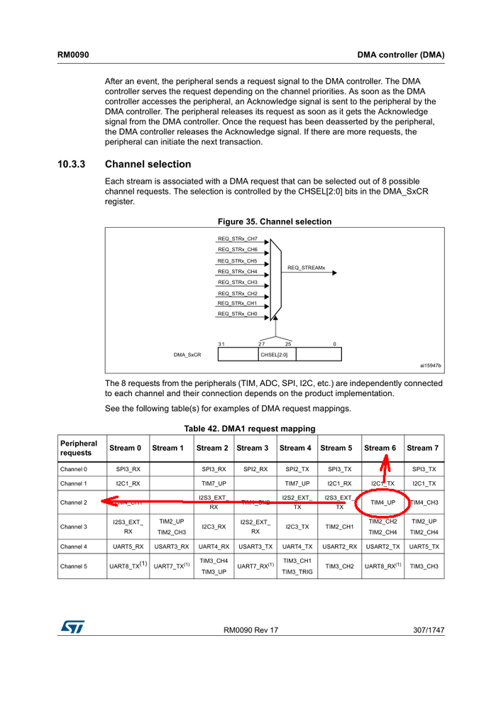

waclawek.jan
> |( 1 * DMA_SxCR_CHSEL_2) // CHANNEL 2 SELECTED
No. DMA_SxCR_CHSEL_2 is bit 2 of the CHSEL bitfield, so this sets the CHSEL bitfield to 0b100 = 4 i.e. you've selected channel 4.
You want
|( 2 * DMA_SxCR_CHSEL_0) // CHANNEL 2 SELECTED
or, maybe visually better, if you have newer header file (the ***_Pos symbols were not defined in the headers in the SPL era)
| (2 << DMA_SxCR_CHSEL_Pos)
> TIM4 -> DIER |= TIM_DIER_UDE; // UPDATE DMA REQUEST ENABLE
yes, that's better than triggering DMA from CC3, but then you need not Channel 7 but channel 6:
If after doing this still no cigar, read out the registers' content in debugger and check/post.
