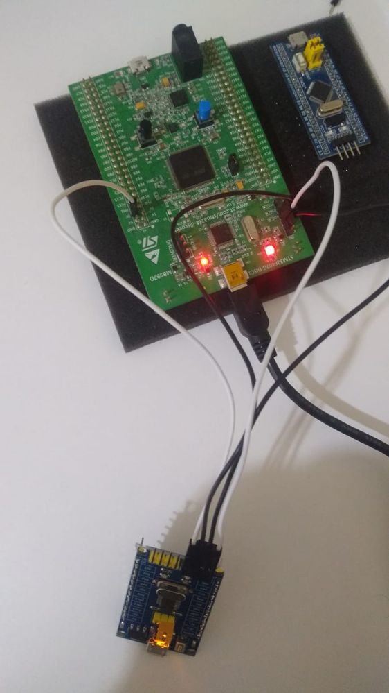

Hello. This is my first post here. I'm pretty unexperienced at the hardware side of MCU's and I want to debug my STM32F304P6 processor (on an unofficial board) through debugger of STM32F407VG Discovery Board. I connected SWD pins ( 2nd to CLK, 4th to DIO, GND to GND and 3v3 to 3.3V on Discovery) and unplugged CN3 headers. And I get can not find target error. Than I tried to connect 5th SWD pin with NRST on board but the result is same. I read the documentation and I don't know where am I doing wrong. Thanks
PS: I tried the same method with STM32F103 too. Result is same. Discovery board works well.

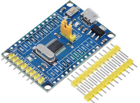

Unofficial STM32F034P6 Board:

Make sure the ST-LINK has current firmware that recognizes the F0 part, also keep the connection speed down, perhaps 1 or 2 MHz
EUygu.1
EUygu.1Author
November 7, 2020
I tried on 1.8 MHz but did not work.
November 7, 2020
> STM32f0304P6
> STM32F304P6
> STM32F034P6
Three references and three different typos.
Make sure the target board has power. The SWD connector pin 1 does not provide power.
EUygu.1
EUygu.1Author
November 7, 2020
I'm sure that board has power. I connected 3.3v via 3.3 pin of Discovery board. Not the SWD.

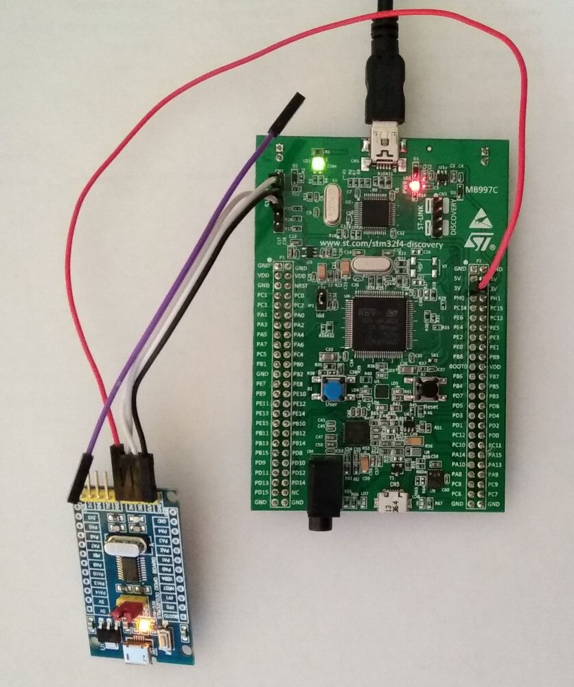

Would you mind giving any *precise* information? E.g. there is no 3.3V pin on the discovery board, so ...?. How did you attempt to connect (which software), what's the *precise* error message you get? "I'm sure that board has power" isn't useful at all. Whether you *think* it is powered and whether it *is* powered are two very different things. Did you verify with a voltmeter?
Andreas Bolsch
Lead III
November 8, 2020
0693W000005AhubQAC.jpgWorks without trouble. The error appearing in the log is due to the 'blinky' firmware on the F030. Pressing the (Reset-) button on the F030-board cures this.

@Andreas Bolsch​ I did the same connections with you and tested on ST-Link Utility and STM32Cubeide by using ST Link GDB Server (sorry as I say 3.3 I mean 3 that's a terrible mistake). And having errors on both of them. I'm using latest debugger frimware on STM32 Debug+Mass Storage+VCP type. I tried on different clock speeds. Thanks for your respond
