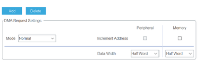

Hi All, I'm using an STM32F1 with a 240x240 LCD screen that comunicates with the micro by SPI (with DMA). The screen uses the ST7789 driver (I supose it is not important). I'm working with RGB565 color format.
The problem that I have is, for example, when I'm using the ST7789_Fill_Color(YELLOW); the SPI uses the DMA and the LCD shoul be yellow but it's not. If yellow is 0b1111 1111 1110 0000 the DMA only sends to SPI the LSB (0b0000 0000 1110 0000) witch is a wrong color.
When I do the same without DMA it work's fine!
The DMA is configures this way:
I tried every configuration possible but nothing works. My question is why the DMA only graps the first byte of a color and what I have to change in order to send the real color.
Thanks in advance!!!

‎2023-08-15 10:58 AM - edited ‎2023-08-15 10:59 AM
Hello, sorry I didn't see the message on time. Yes it is library fault and I have solved it. If you still need the library I can send it to you!

‎2023-12-22 09:26 AM - edited ‎2023-12-23 05:16 AM
Hi @BTurc.2
I have very similar setup with ST7789 240x240 display but MCU is STM32F746ZG (NUCLEO board). I use the same display library and the same SPI1+DMA setup. Problem always happens after DMA transfer request here:
static void ST7789_WriteData(uint8_t *buff, size_t buff_size) {
HAL_SPI_Transmit_DMA(&ST7789_SPI_PORT, buff, chunk_size);
while (ST7789_SPI_PORT.hdmatx->State != HAL_DMA_STATE_READY) {}
To fill the screen, 115200 bytes (240 * 240 * 2) must be transferred to display via SPI. Default buffer size is 2400 bytes and chunk size is the same as buffer (2400 bytes). ST7789_Fill_Color() calls ST7789_WriteData() 48 times and stuck. After 48 DMA transactions (48 * 2400 = 115200) there is no more HAL_DMA_STATE_READY signal, DMA becomes always BUSY and code stuck in the infinite while loop.
Even if I make buffer size 115200 bytes and chunk size 57600 bytes, HAL_SPI_Transmit_DMA() makes only 2 transactions by 57600 bytes and becomes always BUSY again.
Did you have such problem?
UPDATE:
Problem was in the code attempting to transfer the memory outside buffer boundaries.
With DMA full frame transfer of 240x240x2 = 115200 bytes takes 64 ms.
Updates uploaded to GitHub
