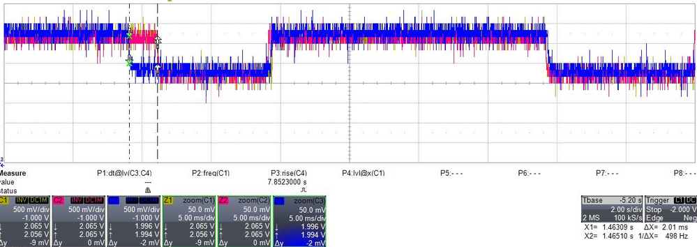

Hi everyone, I'm new to MCUs and programming in general and currently trying to calculate the average of the plateaus from 3 ADC input channels. I'm using Exponential Smoothing to reduce the noise and an algorithm to detect the plateau. Even tho my signals are similar, there's a slight shift and that's always less than 3ms.
My goal is to run the algorithm for only one channel and when it detects a plateau, it'd wait 3ms before it starts averaging for all the channels. Averaging would stop after some ms. I'm using HAL_Delay and HAL_GetTick for this purpose but it looks like I get different values than reality.

> In what way?
I get lower voltage values than expected. My sensor runs/scans for a certain amount of time and the number of plateaus are also known. So, I'm guessing the delay function doesn't work with the current implementation. Because, when I run this for single-channel where the delay isn't necessary, I get expected values that also match with the values I read on the Oscilloscope or Multimeter. For single-channel, I don't use DMA but I'm not sure if DMA is the problem here.
Thanks for the suggestions on optimizing the efficiency. I thought about most of them but the implementation seems a bit complicated for me at this moment. Also, my application isn't sensitive to the delay resolution. I can afford to have 4ms delays as well.
