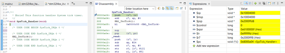

Disassembly and register values are as following:
On SysTick interrupt handler entry:

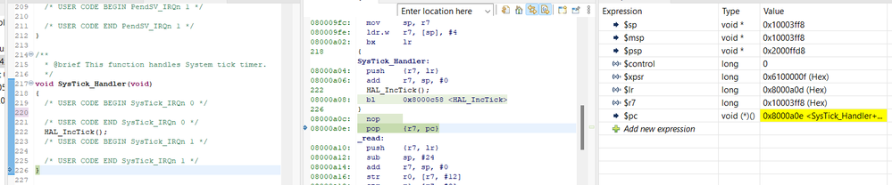

On SysTick interrupt handler exit(`pop {r7,pc}` causes hardfault):
RCcCK

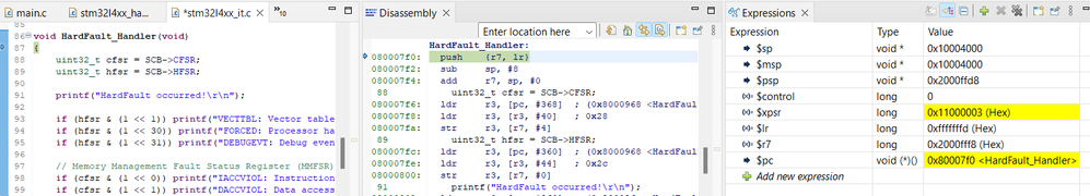

On Hard Fault exception entry:
3XPY1

In STM32L432KC data sheet in section 3.5 Embedded SRAM.
STM32L432xx devices feature 64 Kbyte of embedded SRAM. This SRAM is split into two blocks:
48 Kbyte mapped at address 0x2000 0000 (SRAM1)
16 Kbyte located at address 0x1000 0000 with hardware parity check (SRAM2). This memory is also mapped at address 0x2000 C000, offering a contiguous address space with the SRAM1
So the problem is in the linker script RAM length is given as the total of RAM1 and RAM2. And RAM2 is also mapped to be accessible after RAM1.
Linker script in the original post leads to _e_ram2_stack being equal to _e_ram_stack after mapping. So MSP and PSP is using same memory location.
The fix:
_e_ram1_stack  = ORIGIN(RAM1) + LENGTH(RAM1);
_e_ram2_stack  = ORIGIN(RAM2) + LENGTH(RAM2);
RAM1   (xrw)    : ORIGIN = 0x20000000,   LENGTH = 48K # was 64K in original script
RAM2   (xrw)    : ORIGIN = 0x10000000,   LENGTH = 16K
