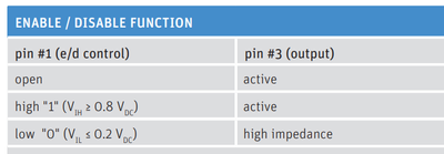

Im planing on using a Jo22 oscillator with 24 Mhz: https://www.jauch.com/downloadfile/5ef1edcfb7fd5cebb9856be49a6932f5e/jo22-1.8-3.3v.pdf%C2%A0
Are there any things i have to look out for?
I havent found a example circuit, and the datasheet of the oscillator speaks of different load capacitances. What is this capacitance?

Well, the manufacturer of the oscillator should be able to answer your questions. However, oscillators are quite easy to use and only need to be connected to VCC, GND and the output to the OSC_IN. In addition, the enable pin must be connected, whereby I assume that with Jauch the oscillator is enabled with high at pin e/d and in standby with low.
As far as the load capacitance is concerned, this refers to the capacitance at the output. However, if you keep the connection to the OSC_IN very short, you should only add a few pF to the PCB capacitance of a few pF.

@Tesla DeLorean The load capacity is not a setpoint or minimum value, but the maximum capacitance that the output of the oscillator can drive. Hence my statement that the perhaps 3...5pF board capacitance + perhaps 2...4pF line capacitance can easily be driven by the oscillator without the need for a buffer in between.
Do you agree?
AScha.3
This is an active oscillator, generating 24MHz output; the load cap is the maximum load, it can drive within its spec, so dont worry about this; just place the Jo22 close the cpu and a 100nF cer. cap close to the Jo22 .
My extra recommendation is to put a serial damping resistor , about 51 ohm, in the 24M clock trace to the cpu, to prevent any ringing.
And enable pin to Vcc : (= high)
