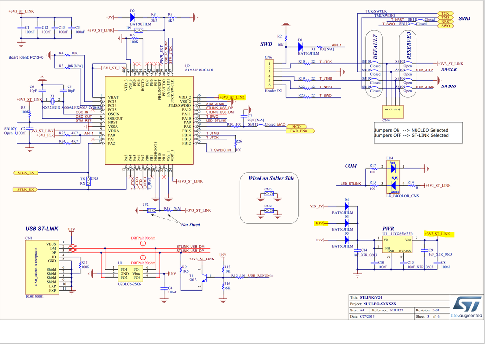

Many Nucleo boards, including the NUCLEO-F446RE mentioned here, do not have an HSE crystal. Instead, OSC_IN of the target is driven by the MCO of the ST-LINK.
This leads exactly to the behavior you observed: the HSE can only be operated in bypass mode without removing the jumper to the MCO and without soldering a crystal, the STM32F446 therefore gets its clock from the ST-LINK via the MCO.
As soon as the NUCLEO is not supplied via USB but an external voltage, the clock from the ST-LINK is therefore missing.
I have already mentioned the solution: remove the solder bridge to the MCO (at the NUCLEO-F446RE this is the SB50) and solder on crystal X3 including the passive components (R35, R37, C33, C34).

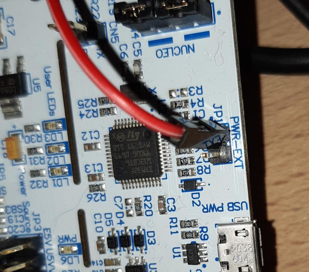

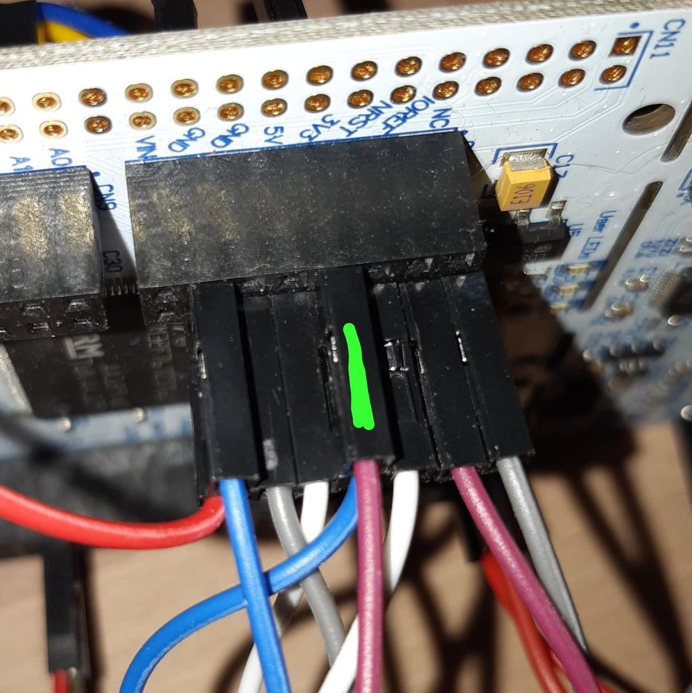

harald
Hy. I was facing the same issue with a F767ZI. Systems works perfectly when ST Link USB is plugged in and does not work only on external power supply. What did the trick for me was powering ST-Link part of the Nucleo from the 3V3 of the main board by connecting CN8 Pin 7 to JP1 Pin 1. Then ST-Link is powered even without USB and its HSE runs and can supply main board with clock. I use the "user USB" on the other end of the Nucleo board, so I needed high accuracy clock and could not live with other clock source.

@Peter BENSCH​ Im aware of it and yes this applies to the nucleo being powered via E5V and the USB not connected. When I first found this thread, i thought why the LD4 of the ST Link happens to blink. That meant the ST Link is powered. See the schematics of the F429ZI. (MB1137)0693W00000JQ2LnQAL.png
