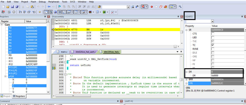

I don't understand there's nothing on USART_DR USART2 register,
but when I checked with PC there are many datas from GPS module,
Any wrong initialization ?

I got it work with UART1, still don't understand, why isn't it working with UART2 ??? anyone ?
