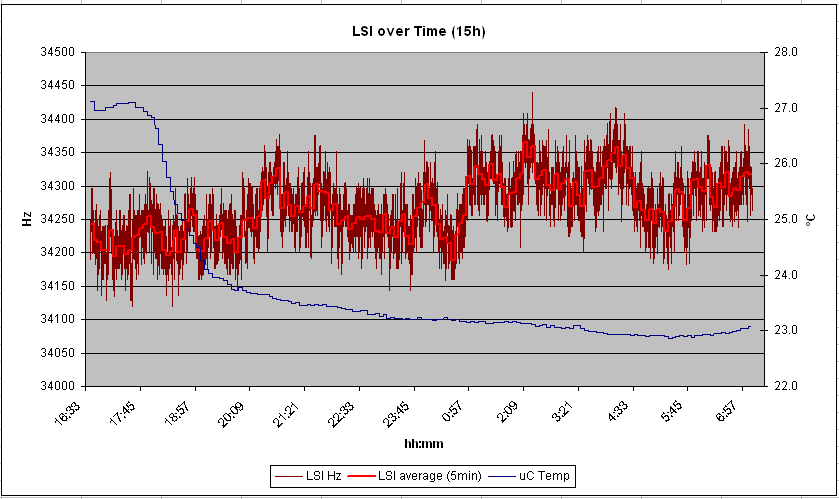

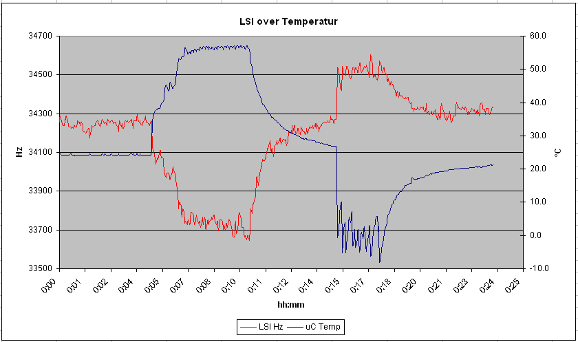

ter
Posted on March 01, 2013 at 13:38
Hi
If someone is interested, i made measures regarding this issue. Even after calibration, the LSI's frequency changes with temperature, therefore not accurate for most RTC applications
Measurement frequency shift over Temperature:0690X00000604yKQAQ.png
...over time
Regards
Posted on March 01, 2013 at 15:46
Not least the fact that LSI can't maintain the RTC at all on battery.
