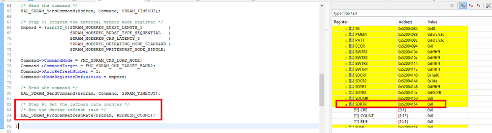

Here some update for the topic.
I was trying to change the refresh rate according to the proposal to 400:
#define REFRESH_COUNT                    ((uint32_t)0x0190)   /* SDRAM refresh counter (100Mhz SD clock) */
which is set by the last step in the initialization function:
  /* Step 6: Set the refresh rate counter */
  /* Set the device refresh rate */
  HAL_SDRAM_ProgramRefreshRate(hsdram, REFRESH_COUNT);
that runs this one:
HAL_StatusTypeDef FMC_SDRAM_ProgramRefreshRate(FMC_SDRAM_TypeDef *Device, uint32_t RefreshRate)
  /* Check the parameters */
  assert_param(IS_FMC_SDRAM_DEVICE(Device));
  assert_param(IS_FMC_REFRESH_RATE(RefreshRate));
  /* Set the refresh rate in command register */
  MODIFY_REG(Device->SDRTR, FMC_SDRTR_COUNT, (RefreshRate << FMC_SDRTR_COUNT_Pos));
  return HAL_OK;
So it should set the SDRTR register to the value 0x0190.
After setting a breakpoint just after this function, the register has a value of 0x0:
Now I' checking why this is so, but this dosen't supose to look like this...

Hello!
I have found the problem. The reason, why the register was not set, was very easy: I forgot to change in the SDRAM initialization function the number of the SDRAM to 2 (since I'm using the SDRAM2).
You can see here the sdramHandle is set to hsdram2 and everything works fine :)
void BSP_SDRAM_Init(void)
	sdramHandle = hsdram2;
    /* Program the SDRAM external device */
    SDRAM_Initialization_Sequence(&sdramHandle, &command);
  * @brief  Perform the SDRAM external memory inialization sequence
  * @param  hsdram: SDRAM handle
  * @param  Command: Pointer to SDRAM command structure
  * @retval None
void SDRAM_Initialization_Sequence(SDRAM_HandleTypeDef *hsdram, FMC_SDRAM_CommandTypeDef *Command)
  __IO uint32_t tmpmrd =0;
  /* Step 1:  Configure a clock configuration enable command */
  Command->CommandMode = FMC_SDRAM_CMD_CLK_ENABLE;
  Command->CommandTarget = FMC_SDRAM_CMD_TARGET_BANK2;;
  Command->AutoRefreshNumber = 1;
  Command->ModeRegisterDefinition = 0;
  /* Send the command */
  HAL_SDRAM_SendCommand(hsdram, Command, SDRAM_TIMEOUT);
I have checked the registers and they are set now correctly.

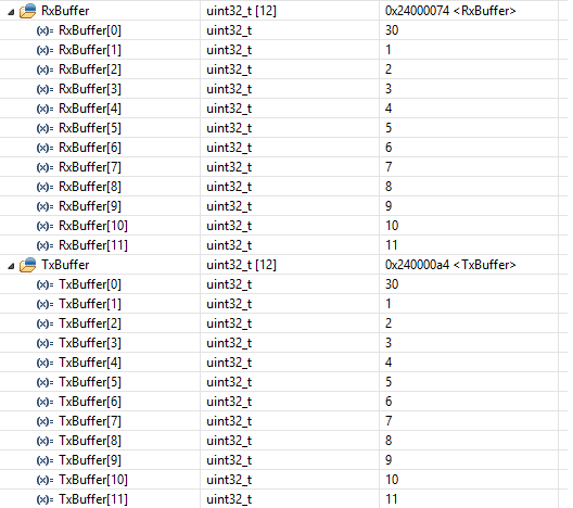

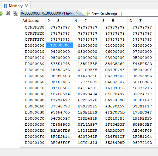

I also wrote a simple code to do a first test:
  • fill Tx Buffer with some numbers
  • write Tx_Buffer to SDRAM starting at 0xD000 0000
  • read the SDRAM into a Rx_Buffer starting from 0xD000 0000
The result is fine in memory view and variable check:
Thank you all for all the help!
