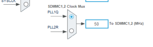

Additional observations: CubeMX configures the SDMMC1 kernel clock to 150 MHz. From the reference manual / datasheet, it seems the maximum SDMMC kernel clock should be around 125 MHz.I am not sure if this clock configuration could be related to the issue.
But the initialization still fails at CMD55.
Questions:Is a 150 MHz SDMMC kernel clock supported on STM32H753?Is there any additional initialization required for the external SD transceiver (IP4856CX35) on this board?Is there a known issue with CubeMX generated SDMMC code for STM32H753I-EVAL2?

Set the clock for SD-card to 50MHz .
As this is max frequency for SD-card.
And set 1bit mode at first, as 4bit mode more difficult.

There you had 150M as clock, that never can work.
Now - new tests needed.
If still same problem, there never was a working connection to the card.
And check (in PC) card: still working fine ? (I killed a card , just by trying to clock it with 100MHz.)

As I mentioned in the later posts , I have already reduced the sdmmc kernel
clock to 50Mhz , and clock div is 0. So it should be 50Mhz itself (during
initialisation the code itself calculates the clock div to maintain under
400Khz which is a requirement for sd card)
