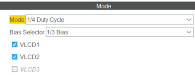

I am working on a STM32L073V8T6. I want to use the 1/3 bias functionnality to manage a screen.

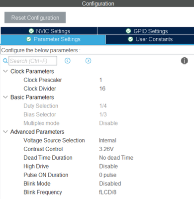

I have configured the contrast control to 3.26V, the Mode to 1/4 Duty Cycle and the Bias Selector to 1/3 Bias.
But if I write something to COM0 and I look at the signal with the scope, I get 4 levels :
0V -- 1.3V -- 2.0V and 3.3V instead of :
0V -- 1.1V -- 2.2V and 3.3V.
I have already added 150nF external capacitors on and configured the resistors with the software to have low resistors.
Why do I have 1.3V and 2.0 instead of 1.1V and 2.2V ? Is there something that I have forgotten ?

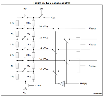

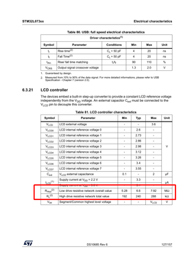

Also, I couldn't find the RL and RH values in the datasheet. Is it possible to have it, plase ?

Is this under load?
Have you tried High drive?
Thank you for your answer.
I have tried it both loaded and unloaded. The results are the same.
I also tried with High Drive, but it made no difference.
Thank you for the screenshot of RL and RH.
