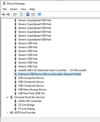

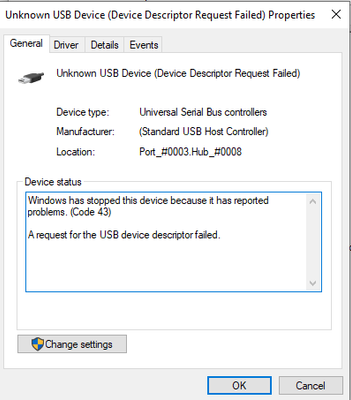

Hi, I want to get log using Type-c, and using freertos to run all the tasks.
setting:
MCU STM32L4A6VG
STM32CubeIDE 1.12.0
STM32CubeMX  6.8.0
tera term 4.106
when i insert Type-c, device manager return the unknown usb.

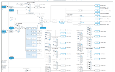

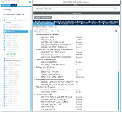

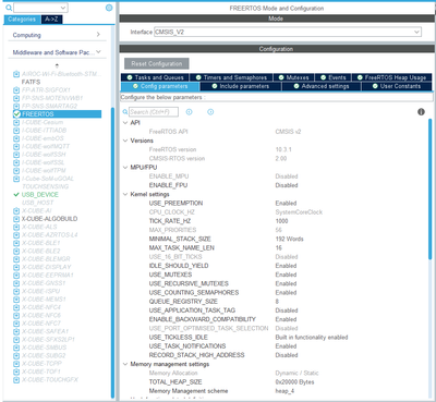

I try some methods:
1. put MX_USB_DEVICE_Init() before  MX_FREERTOS_Init() -->unknown usb error 43
2. put MX_USB_DEVICE_Init() in task -->unknown usb error 43
3. increase MINIMAL_STACK_SIZE to 1024  -->unknown usb error 43  (ref: https://community.st.com/t5/stm32cubemx-mcus/nucleo-h723zg-usb-cdc-communication-not-working-when-using/m-p/662907 )
4. change clock output  -->unknown usb error 43(ref: https://community.st.com/t5/stm32cubemx-mcus/unknown-usb-device-on-stm32f429zi-device/m-p/75508 )

Hi @alyssa
You  need to ensure that the D+ and D- lines in design are equal in length and respect differential pair routing guidelines as referenced in AN4879 is crucial for maintaining signal integrity and achieving reliable USB communication. In your screenshot 102632 these rules are not respected. D+ and D- lines should be of equal length and consistent spacing.

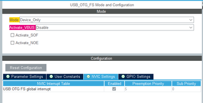

Can you include your code?
You definitely need USB interrupts enabled.

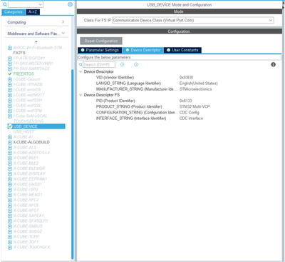

Hi @alyssa
Based on these attachments, there might be missing or incorrect device descriptors in your configuration. You need to check them.
Best regards,
FBL
alyssa
thank you for you reply.
If you say the interrupt in NVIC settings. I have set it before (sorry make you confused), but still get unknown usb error 43.
i attach the main.c below. (for just testing usb, i disable the FreeRTOS)
but i dont think this is a FW problem.
because when i  use Full chip erase by STM32CubeProgrammer v2.13.0, the PC still tell me the unknown usb error 43.
i think without the FW, PC can recognize STM32 BOOTLOADER when insert usb.
