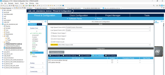

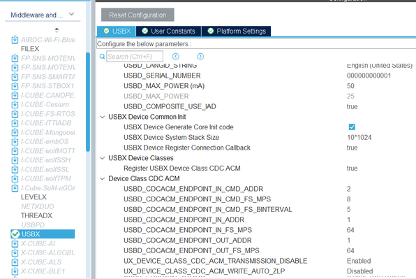

I have created a project, with the following configurations in the .ioc file;
Time Source : SysTick;
In Project Manager section, I have increased the, Minimum Heap size to 0x1000, and stack size to 0x600.

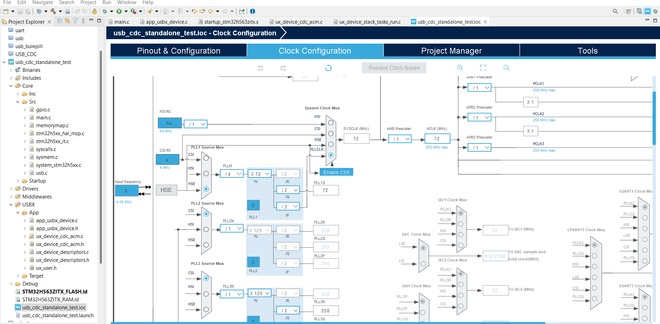

Clock configuration settings is as follows; (USB is receiving 48MHz through HSI48 clock).

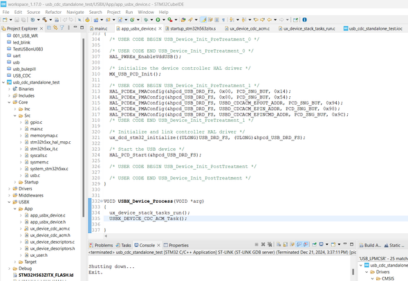

And I have created a task, USBX_DEVICE_CDC_ACM_Task(); for data receiving and transmission
and calling the USBX_Device_Process() function in main.c file, in while loop.
I hope, I have given the configurations correctly and calling all the functions in correct order...
Please let me know if I am wrong anywhere here.
When I run the code, it's getting stuck inside the task; in line 177 as shown below;
(Even without the while loop inside this task, the code didn't work)
Seriously? You have PLL sourced from HSE.

1. HSE oscillator mode should be set to Bypass.
2. USB FIFO configuration is incorrect - wrong last argument values in HAL_PCDEx_PMAConfig*** calls.
3. USB clocking with HSI48 is ok assuming you set CRS sync to USB SOF (which you did).
