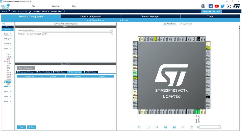

Hello @WGand.1​ ,
Thanks for your feedback,
I advice you to use CubeMX which is a free tool that allows a very easy configuration of STM32 microcontrollers and microprocessors even for beginners, it also generates the corresponding initialization C code.
Please check this tutorial Getting started with STM32CubeMX
Even with CubeMX you can change the default pin assigned to the IP and use alternative function. You can simply hold the CTRL key and right click on the mouse on the pin and it will show you all the possible changes.
0693W00000JPApIQAX.pngFor more details about this subject, please check my answer in this thread STM32CubeMX - Pinout Config - Select Alternative pins
