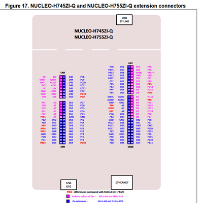

you agree that in the schematic, PD8 and PD9 are in that configuration, but in fact the problem is not them, these two pins work correctly.
Just one thing though, on the NUCLEO-H755ZI-Q, how can I connect them? correct me if I’m wrong, but in the diagram where all pins are represented, these are not there.
STM32H7 Nucleo-144 boards (MB1363) - User manual
What I'm saying is the pin choices are not driven by your imagination, but physical plumbing on the board you've chosen.
You can pick other pin pairs for USART3, but these aren't connected to anything that's going to output to your terminal application. You will need to physically connect something to these new pins to observe the output. This could be a scope or logic analyzer if that's sufficient to confirm the signals are present.
The H755 provide multiple ways to escape different peripheral pins, the AF (Alternate Function) mapping is described in the part data sheet. The wiring manifested on the board is best described by the schematic. You can see which are committed to specific functions, and which are still free to use, and access via the pin headers.
To escape PD8/PD9 you'll probably need to make/break some solder bridges so they appear at the Arduino D0/D1 header positions.
