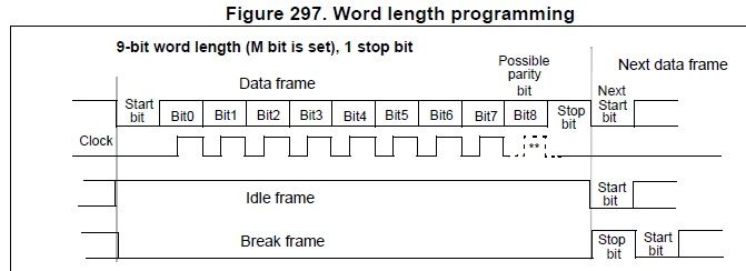

‎2015-08-04 7:13 PM
hi,I read the manual ,it says :''An Idle character is interpreted as an entire frame of “1�?s followed by the start bit of the next
frame which contains data (The number of “1�? ‘s will include the number of stop bits).'' ,So it needs a start bit ,i think this method cannot cause a interrut- Mark as New
‎2015-08-04 8:15 PM
I read the manual ,it says :''An Idle character is interpreted as an entire frame of ?1?s followed by the start bit of the next frame which contains data (The number of ?1? ?s will include the number of stop bits).'' , So it needs a start bit, i think this method cannot cause a interrupt
The diagram however pretty much defines that the idle frame is absent a start bit, it's basically an entire symbol time with the signal high.Up vote any posts that you find helpful, it shows what's working..
