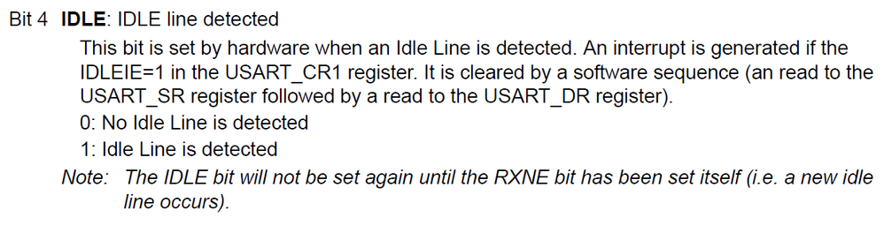

I have an idle interrupt, on usart2 handle;
void USART2_IRQHandler(void)
/* USER CODE BEGIN USART2_IRQn 0 */
/* UART IDLE Interrupt */
if(__HAL_UART_GET_FLAG(&huart2, UART_FLAG_IDLE) == SET)
__HAL_UART_CLEAR_IDLEFLAG(&huart2);
receivedDataFlag = 1;
When I use the this function check line idle states and decide the data received or not received. But this interrup trigger while transmitting. How can I seperate receive data line idle and receive idle ?
I want to trigger just receive data line idle, how can I do that ? What other register should I look at?

2021-06-18 6:48 AM
Which STM32?
Generally, in UART, transmitter and receiver are almost entirely independent units, so you can't "refresh" the Idle timer by transmitting.
One method may be to connect the Rx pin also to a timer pin externally, and handle the idle state in that timer.

You didn't answer JW's question.
The RM of the STM32F4 says IDLE is only set for reception events. Perhaps the data on the line is not what you think it is.

It could also be that you're not ready to receive by the time the transmitter sends the next byte. You mentioned using blocking receive function.
Transmitting doesn't affect the IDLE flag. Look somewhere else for the solution.
