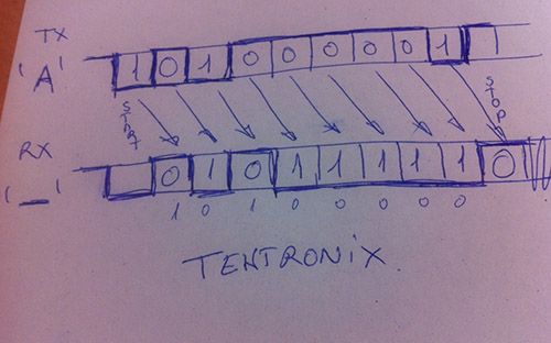

I receive chars, but not what i want.
I am sendig 'U' and i will see in the oscilloscope, i will upload a image with the results.
When I send 'U' I receive ''U'' in tera term, but when I send ''A'', I  receive ''_'' in tera term, For 'B' sent, i receive ''/'', etc...
Posted on April 05, 2013 at 00:23
''i will see in the oscilloscope, i will upload a image with the results''
Do take time to think about what you see before uploading it
''When I send 'U' I receive 'U' in tera term, but when I send 'A', I  receive '_' in tera term, For 'B' sent, i receive '/', etc...''
To say ''etc'' implies that there is a regular pattern - so think about what that pattern could be; and think about what might cause it...
Hint: Draw the waveform for the ''sent'' character, and the waveform for the ''received'' character - and compare them...
The most important tool for debugging is the one between your ears...
manespgav
Posted on April 05, 2013 at 11:48
Thanks a lot mate! As you just said, I realised what the error is.
Will try using a TTL Usart USB device.
This is my oscilloscope's capture:
Posted on April 05, 2013 at 13:11
Use a proper level convertor (MAX3232 and similar).
PS. We see this kind of error quite a lot here (it was quite regular on 8052.com in its heydays, too, IIRC; and I guess this will be quite common in other fora dealing with mcus). A canned answer with links would be nice. http://retired.beyondlogic.org/serial/serial1.htm#40 could be one of them,  http://hw-server.com/rs-232-overview-rs-232-standard is more extensive but also harder to read. There surely are others; please suggest and comment.
manespgav
Posted on April 05, 2013 at 13:34
Thanks a lot! Trying with a TTL USB this evening.
SOLVED.
