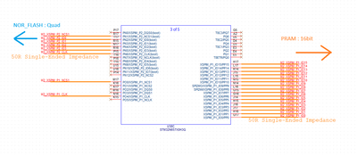

This is my first time using an STM32N6 without internal flash, and since I am right before handing over files for artwork, I would appreciate it if you could check if the power lines and XSPI memory connections are correct.
I have searched around a lot, but since it is my first time, I feel a bit nervous, so please let me know if everything is correct.
I looked it up and found that to boot via Nor-Flash (quad), I need to connect XSPI1 to XSPIM_P2. Also, since I try to connect the 16-bit PRAM in DTR without DQS mode, I connected it as XSPI2->XSPIM_P1. Is this correct? I really need to BOOT via Nor-Flash and use PRAM after that. (swapped mode? in CubeMX)

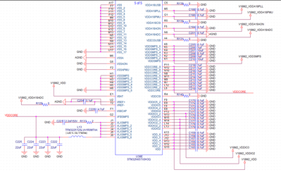

This is the power line. It operates at 1.8V, and an STM employee told me to connect all CSI/USB lines to ground if I am not using CSI/USB. Is this the correct way like this all? I won't be able to fix it if the power section is wrong, so I would really appreciate it if you could let me know.

Hello @AndersonKKK ;

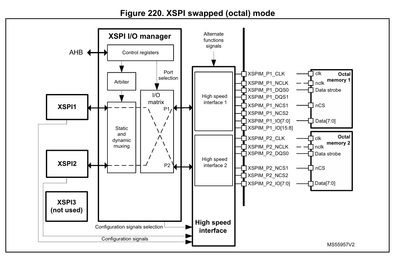

The swapped mode is similar to XSPI direct mode, but the ports are swapped, to help I/O mapping.
In swapped mode, the XSPI2 can be configured in 16-bit mode, and the XSPI1 can be configured in octal mode, to connect an external 16-bit memory on Port 1, and to connect in a concurrent way an octal external memory connected to Port 2 of the I/O manager.
To check a hardware connection, I recommend you to look at Getting started with hardware development for STM32N6 MCUs - Application note.
Thank you.
Kaouthar
