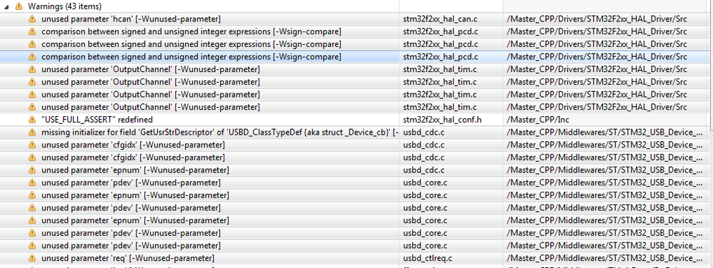

I've just been pointed at this function by my compiler warnings and am wondering what's going on here?
The parameter uint32_t OutputChannel is clearly not used, instead channel 1 AND 2 are always started together.
This must either be intended behaviour for some hardware reason OR a bug.
In case 1: Please remove the parameter and explain the situation in the function comment.
Case 2: Please fix by actually using the parameter.
CubeMX 4.1
up-to-date F2 FW package
file: stm32f2xx_hal_tim.c line 2107
The same goes for:
- HAL_TIM_OnePulse_Stop
- HAL_TIM_OnePulse_Start_IT and
- HAL_TIM_OnePulse_Stop_IT
Thanks!

Btw, there are quite a bit of those unused parameters going on in the ST drivers alone.
I think that drivers and middleware intended for public use should be warning-free even in +wextra and +wpedantic mode. Does anybody disagree?

I confirm: this is a known issue and it will be fixed in the next release of STM32CubeF2 firmware package.
