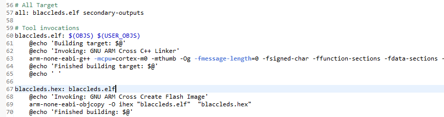

What's going on at line 61 of the make file?
What's the script it is trying to run?
‎2017-07-13 8:38 AM
This is the part of the makefile:

Will
arm-none-eabi-g++ run from the command line?
What if you paste in the entire command it is trying to run?
system_DEVICE looks odd, does DEVICE need to be defined?
The escape character at the end here looks problematic ...
STM32L0xx_HAL_Driver\'
Use the UNIX path setting for where it should be looking for driver objects.
