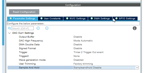

I also wanted to try DC voltage in RAM by modifying the Sinewave example.
I did two things: (1) for sinewave value array, I put same value for all; (2) I set the DAC trigger timer to be a large value.
However, DAC output voltage drops very fast. I wonder how to maintain the DAC output voltage level.
I enable DAC SampleandHold and use the longest value for sample and hold time. It still does not work.
Do you mind sending me your code? Thx.

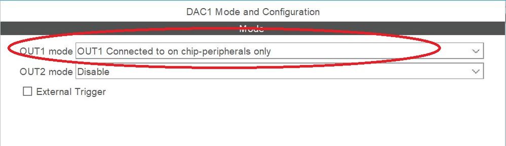

Igor Cesko
Hi HDaji.1,
Do not use sample and hold mode for the DAC. Modify the example in the STM32CubeMX - this is the easiest way to modify the project (*.ioc file in the example is the file for STM32CubeMX). In STM32CubeMX change the DAC mode and build the example again.
Regards
Igor
You mean this one0693W00000GXOluQAH.jpgand this one
sConfig.DAC_OutputBuffer = DAC_OUTPUTBUFFER_DISABLE;
 BTW, I am using CubeIDE not CubeMX
I used back the original OPAMP_PGA code, now the DAC output voltage is sustained. Thx.
Igor Cesko
Hi HDaji.1 ,
Mode should be "Connected to external pin only".
And "Sample And Hold" should be "Sampleandhold Disable" :
0693W00000GXYX4QAP.png Regards
Igor
Hi Igor,
Is there a way to calibrate OPAMP offset? I found even for the same gain, the offset values are different for my two experiments conducted at different times. That's annoying.
Is there any way to adjust ADC error to 1LSB?
Hi HDaji.1 ,
Please disable "SampleandHold" mode to have stable DC value.
Regards
Igor
