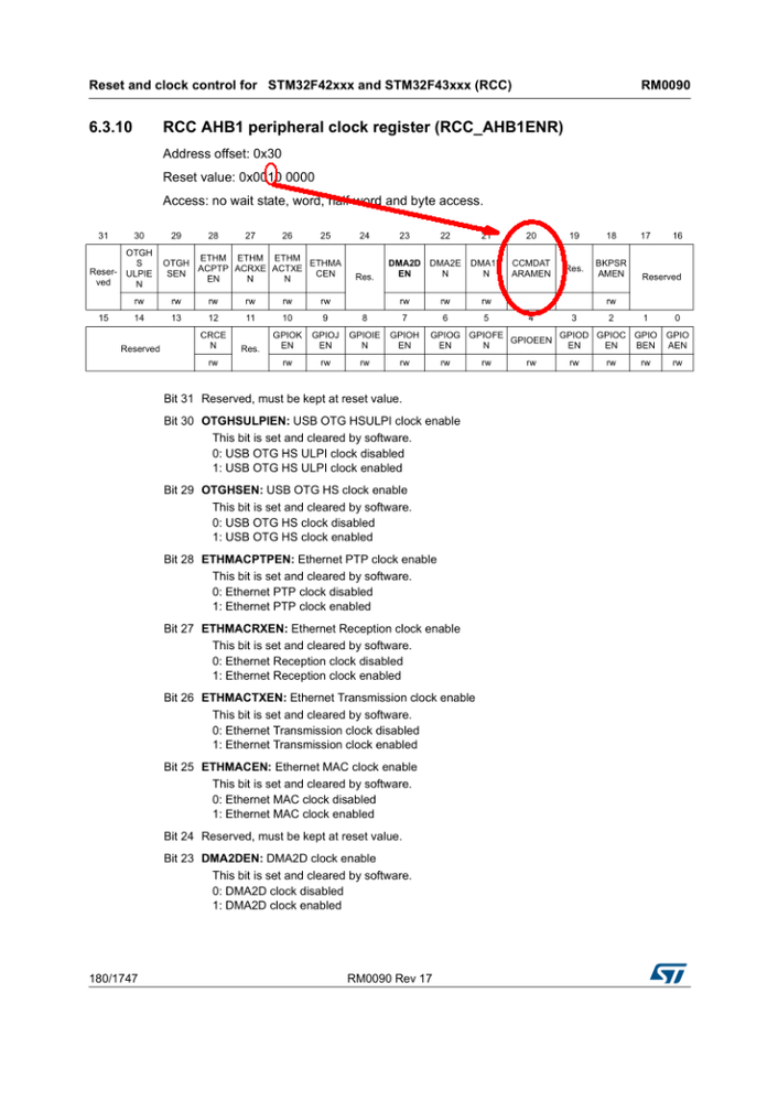

We use the STM32F4 boot loader to load a firmware directly to RAM and run from there, and we noticed that, for an unknown reason, the CCMDATARAMEN bit of RCC_AHB1ENR is not set, making the CCM unusable for very early initialization. Setting the bit manually before any access solves the problem. I'm not sure if this is expected behavior (in which case it ought to be documented in the boot loader application note) or a boot loader bug. Our MCU is an STM32F427.

We confirm, the reset value in the reference manual RM0390 for the RCC_AHB1ENR register is wrong (0x0010 0000) and will be fixed soon to
(0x0000 0000)

No, no, the reset value for RCC_AHB1ENR register IS CORRECT! The CCM memory *is* enabled after reset.
The problem is in the bootloader - when the bootloader exits, it appears to do some housekeeping and stores zero into all RCC_AxByENR registers - but this is incorrect for the RCC_AHB1ENR register. The bootloader ought to store 0x0010'0000 unto it upon exit.

,You are right. In fact, th
e reset value
error is for the RM0390 and NOT RM0090.I will raise the
bootloader issue
to the appropriate team for check and fix.With Regards,

Ah, so it's a separate issue... I didn't realize you've mentioned RM0390 (i.e. 'F446 - that does not have CCR so it's just logical the reset value is 0 there).
Thanks for the clarification.

,CCM RAM should be re-enabled by user code at startup. This will be mentioned in AN26
