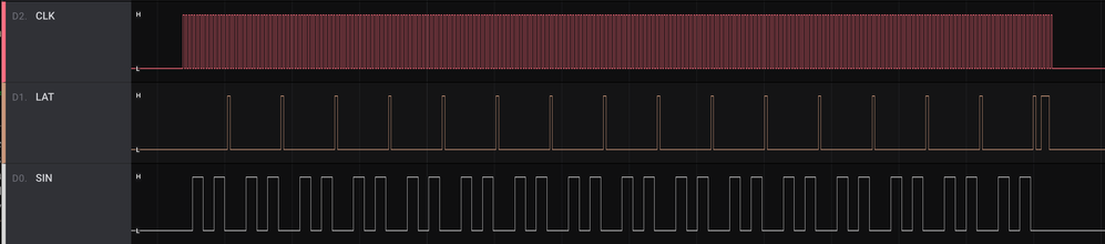

I am using the QSPI (or dual-SPI) interface of the STM32L452 to create instructions for an LED driver using the HAL. I have managed to get it to work but I have to set quite absurd configuration options for the command to make it work.

Here's the output that I expect and that I can achieve using the code above:
Mind that this is a one-off transfer, and is only output when I call the two functions above.

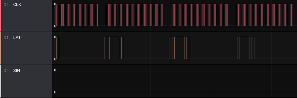

If I do not set both of them, weird things happen. This is the output if I remove the `DdrHoldHalfCycle` parameter:
Mind that this is a continuous signal, which starts and won't stop after I called the transmit function.
What am I missing here? I really shouldn't need those parameters to make it work.

‎2020-12-06 4:55 AM
I figured it out. Was a dumb mistake.
`qspiCommand` needs to be static.
‎2020-12-06 5:33 AM
Automatic/local variables are best explicit cleared. To ensure consistent behaviour.
