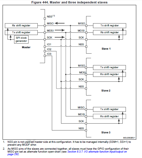

Hi, I have a NUCLEO-F303 board which I would like to use to communicate to two devices using SPI. The NUCLEO would be sending and receiving data to and from the devices via MOSI and MISO.
Looking through the datasheet, I'm very confused by the slave select management bits (SSM and SSI) under master mode, and how I should configure them for my application so that I can manually drive a GPIO pin low for slave select and then clock in/out the data.
Since I have multiple slaves, I'm assuming SSM = 1? On page 964 of the reference manual, it also says '... slave select information is driven internally by the SSI bit value in the register SPIx_CR1...'. So going by that, after I pull a GPIO chip select pin LOW, I also set SSI low to indicate that a slave has been selected? When I tried doing this, I get a frame error in the status register. I also tried leaving the SSI bit high, but the contents of the data register always reads 0xFFFF.
Any clarifications would be greatly appreciated! Thanks!
Below is my code for SPI:

Seb
Posted on December 29, 2016 at 20:03
This is from STM32L4 reference manual. NSS is not needed at master side (unless a rare multi-master SPI system is used)
The note 1 should give clues.
Reminder: The SPI Master communication is completed when RXNE = 1 and BUSY = 0.
When using DMA TX and RX, the interrupt should be on the RX channel as it will come up last.
Good luck!

Posted on December 30, 2016 at 00:16
Thanks for pointing out the SSM and SSI settings.
I'm a confused at this point. If I'm sending data out from the master to slave, a RXNE =1 and BUSY=0 would indicate that communication is completed? Why is it not TXE?
Posted on December 30, 2016 at 10:25
If only transmitting, yes, you are right.
When using 4 wire, RX and TX are done simultaneously. In this case, RXNE will tell that the transfer in both direction is completed (and NSS can be raised).

Andrei Chichak
Lead II
Posted on December 31, 2016 at 08:46
ST has a very weird implementation of SPI with a bunch of features that you don't find on slave chips. The NSS line is used when you have multiple masters on the same bus. I've never seen multiple masters in all of the decades that I've been in this industry, but what do I know. Ignore the section of the manual dealing with playing around with multiple masters and NSS. Use SPI_NSS_SOFT.
I figured I must be dreaming, surely I read the docs wrong. Surely, SPI_NSS_HARD_OUTPUT would do what everybody wants. So I grepped all of the sample code from ST and they use hardware slave select exactly never. I'll have to investigate this later.
Set up your SPI as a master and use the NSS line as another GPIO that you manually toggle (WHY ST? WHY?) along with a couple of extras. You have one master and many slaves.
Don't dick around with pull ups or current limiters either, the slaves are very high impedance and aren't going to be drawing any appreciable current on MOSI or CLK. The values stated above will limit the current available to 80 & 120mA. Since the pins on the processor go poof at 25mA, the processor is not going to be protected by these resistors. Plus, the impedance of the slaves is in the MOhms, so they can't draw more than a few microamps. That is the nature of a digital load.
