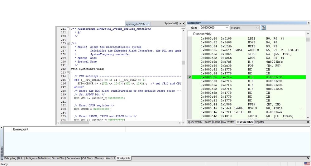

I have tried to debug it as you have suggested. I have disabled the 'Run to main()' option and then start debugging. Debugger stops at ''LDR  ,  , R0, =SystemInit'' first. Then I single step and it goes to 'SystemInit()' function. And immediately after entering into the function it hung at following line:
/* FPU settings ------------------------------------------------------------*/
♯ if (__FPU_PRESENT == 1) &,&, (__FPU_USED == 1)
SCB->,CPACR |= ((3UL <,<, 10*2)|(3UL <,<, 11*2)), /* set CP10 and CP11 Full Access */
♯ endif
Following is the snapshot of the disassembly, when it was hung.
Please help me to resolve this.
Thanks,
Dhaval
Posted on December 31, 2016 at 17:10
These are things that are hard to debug remotely, with minimal information.
I suspect this isn't the initial code being run on the processor, that you have some boot-loader or RTOS running and this is application code you have transferred control too.
You should look at the infinite loop in the context of the boot-loaders memory map and symbols.
Couple of possibilities, it is faulting due to being in a 'user' context, or there is an FPU error it is signalling.
I would suggest you copy the SCB->VTOR setting for the application before setting SCB->CPACR, ie copy the VTOR code from the end of SystemInit() to the front. This way the fault will vector into the symbols space of the application, and something you can see more readily in the debugger.
