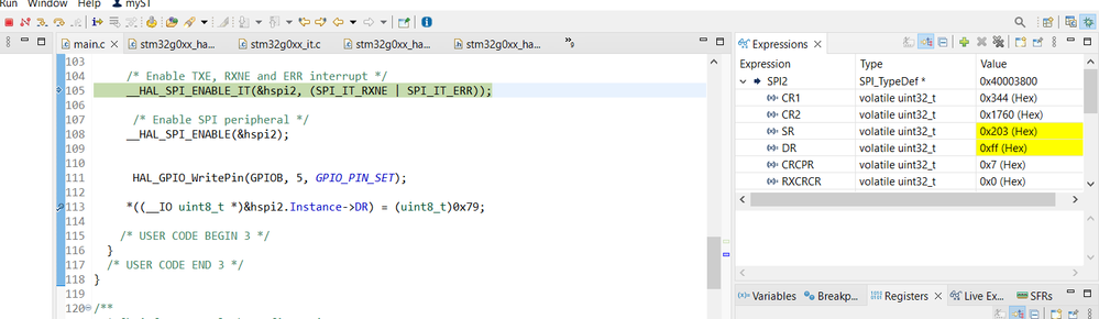

I Have configured STM32G030K6t6 MCU has SPI master . I have used SPI2 Module. Chip select is controlled manually by GPIO .
I am unable to write exact data 0x79 in SPI2->DR register . Always it writes 0xff  to DR and i am unable to read/Write anything from Slave. Kindly provide inputs

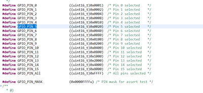

You are not supposed to use a number as the second parameter. Read the comment to that function:
 This parameter can be any combination of GPIO_Pin_x where x can be (0..15).
i.e. you should write
 HAL_GPIO_WritePin(GPIOB, GPIO_Pin_5, GPIO_PIN_RESET);

SPI_DR is not a memory-like register and you won't be able to read back what you've written to it. It in fact is two registers - when you write it, you write into the transmitter's buffer (FIFO), when you read it, you read the receiver's buffer (FIFO).
Observe the SPI signals using oscilloscope/logic analyzer.

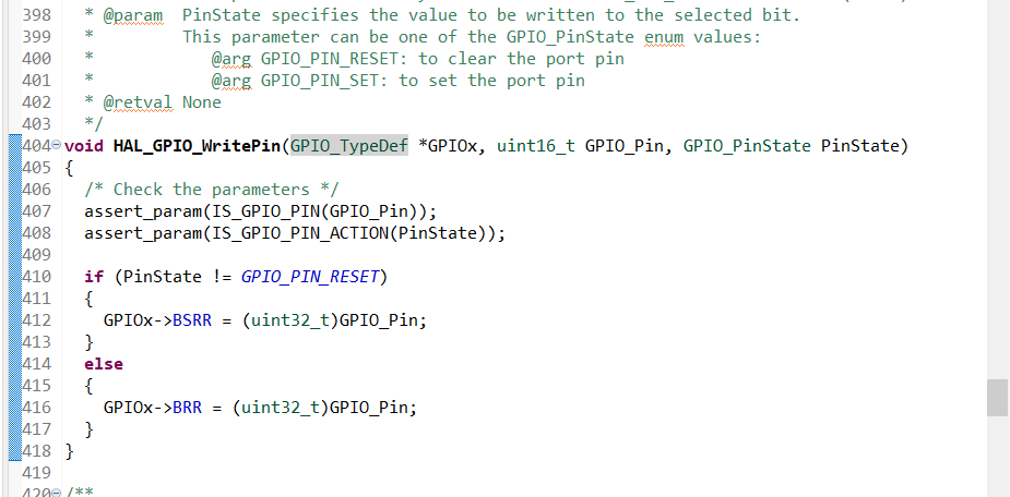

Parking a Peripheral view over registers which change others where read, or FIFOs, will result in interference with normal functionality.
Doing an RMW on ODR will take many bus cycles to complete a load store operation. Whereas using a write to BSRR takes effect in a single cycle of the GPIO clock. It's an atomic / efficiency thing.
But using "HAL_GPIO_WritePin" API is not functioning properly . I am unable to read/write from slave
  * @brief  Set or clear the selected data port bit.
  * @note   This function uses GPIOx_BSRR and GPIOx_BRR registers to allow atomic read/modify
  *         accesses. In this way, there is no risk of an IRQ occurring between
  *         the read and the modify access.
  * @PAram  GPIOx where x can be (A..F) to select the GPIO peripheral for STM32G0xx family
  * @PAram  GPIO_Pin specifies the port bit to be written.
  *         This parameter can be any combination of GPIO_Pin_x where x can be (0..15).
  * @PAram  PinState specifies the value to be written to the selected bit.
  *         This parameter can be one of the GPIO_PinState enum values:
  *            @arg GPIO_PIN_RESET: to clear the port pin
  *            @arg GPIO_PIN_SET: to set the port pin
  * @retval None
void HAL_GPIO_WritePin(GPIO_TypeDef *GPIOx, uint16_t GPIO_Pin, GPIO_PinState PinState)
  /* Check the parameters */
  assert_param(IS_GPIO_PIN(GPIO_Pin));
  assert_param(IS_GPIO_PIN_ACTION(PinState));
  if (PinState != GPIO_PIN_RESET)
    GPIOx->BSRR = (uint32_t)GPIO_Pin;
  else
    GPIOx->BRR = (uint32_t)GPIO_Pin;
 HAL_GPIO_WritePin(GPIOB, 5, GPIO_PIN_RESET);
Probably not an issue with the library code. Check how you're configuring the pin, or if anything external is driving it.
